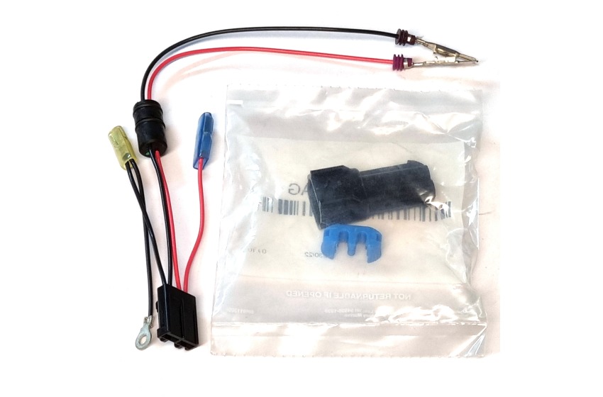

At first thought of looking at the fuel pump wiring harness as seen below, I'd tend to want to lean towards an issue either with the fuel pump harness itself or in the working area of that harness...But since it seems to mostly happen while cranking the engine over?, Plus since you moved the pump housing out of the way, you may have done some damage to the Crankshaft Position wiring harness in which is in close enough proximity to touch the crank sensor wiring as it's mounted to the front cover under/behind the circulating water pump at the front of the engine...See item number 22,
