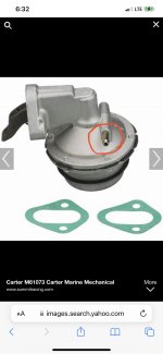

I just had a thought, there’s a little. Nipple towards the top of the pump that nothing on it. Anyone know where it goes to, there’s nothing on it?
dubs283
Jul 27, 2005
5,346
That is the overflow port for a diaphragm rupture. Raw fuel will spill out and fill the bilge, very dangerous
There should be a yellow colored transparent hose from that barb to the carburetor. That way any fuel present will enter the carb/engine and not directly into the bilge
