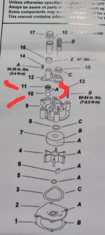

Ok., i have my new water punp. Looking at the service manul, it shows the order to installing the pump
Reading the pump installment instruction are different. Here are 2 pic.
Pump supplier call for number 10 and 11
Manual call number 10 only.

The written instructions are likely clearer than a diagram in the service manual. There are several adhesives and lubricants specified. Use what is spec'd or actual substitutes, i.e. use Permatex aviation on the pump base gasket, and 3 or 4 drops silicone on the oring in the pump cap.
Also use a decent marine grease where 2-4-c is specified.
