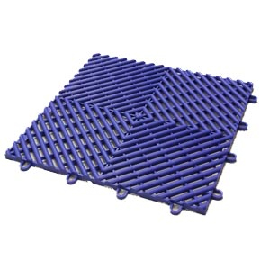

I've read posts going both ways on this. Gluvit is another product that looks like it would do the job of waterproofing the deck. Those grids look like a nice option.
