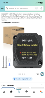

TnTommy
Oct 12, 2025
102
battery isolator that switches between charging starting battery and secondary battery
dingbat
Nov 20, 2001
17,308
Dependent upon rpm, your motor is putting out 5-50 amps per hour of run time.
Given the small output and the use of a AGM, I would go with a charge relay over an isolator
