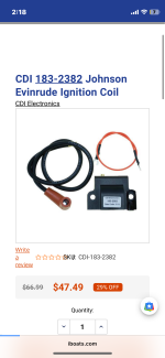

So i had extra ignition coils that are brand new for my 1987 Force 85. They look identical to the one coil thats on my 1969 Evinrude 85hp. I decided to try it out since i have 3 brand new ones instead of buying a specific one for the evinrude. I hooked it up it fired great and operated like it should. Is there anything i should worry about?

Does the Evinrude have CD (electronic) ignition?
From my experience CD ignition system ignition coils has lower resistance at the secondary side then regular magneto system with points and condenser.
Magneto system has about 5-8 kOhm resistance at secondary winding and CD system about 5-1200 Ohm depending on brand.
I would suggest you to check the resistance of the coil for the Evinrude and check the resistance of the Force (I think it is about 5-600 Ohm at the Force coil). If they are about equal and the Force coil fit the Evinrude by the mounting then go with them.

No the evinrude is running on points. I noticed even the right part number is also CDI electronic but for 1969 and some early 70s.
Thanks, i will check the resistance on the coils.

Resistance was almost identical. I noticed on my owners manual it refers to the ignition as C.D ignition . I didnt know evinrude used C.D.I since 1965
