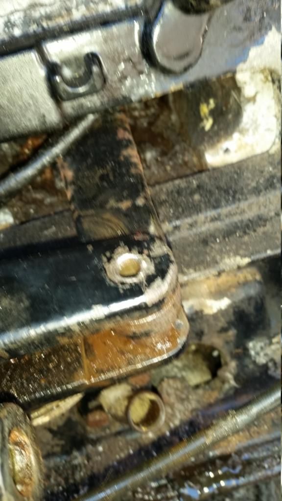

1.Removing shift cable inside of boat, set screw are rusted out and I want to save cable. 2.steering arm removel from hyd. Steering arm, I have a roll pin of some sort and it's stuck.Not showing in mauel, my be retro fitted.pic in this post. Thanks capt. Phil

I don't know what's going on here with post's here. It was at top page then disappeared. So Retype again. 1.on shift cabe inside boat 1982 470, can't get black plastic set screws loose to remove cable.there rusted out.Is there a way with out damagin cable to reuse it? 2. Iam trying to remove gembil transom assembly to fix transom, but having trouble with steering arm, for some reason there's a pin throw clevis and it's stuck in there , it looks like a roll pin but not sure.They also had a small bolt through it with a castle nut it's removed but pin is give me hell.Tried a punch with no luck and not really a place to use a pully. It's in the pic above.Thanks Sorry about post, having some kind of trouble here.

The steering. Assuming it's not power steering, then you should have the steering cable (from the hem) running through a couple of guides/anchor points. There should then be a link arm from the end of the cable to the steering arm from the gimbal ring. As the union at the steering arm/link arm should have a plastic bushing and be moving freely, I'll assume you mean the connection between the link arm and the end of the steering cable. If it's been maintained properly in the past there should be a castellated nut with a split pin. Normally we remove the split pin and the nut unscrews, the arm just lifts out. But if yours is seized, you are going to need to cut the link arm as close to the steering cable as you can get, without touching the steering cable obviously. Once cut, you may be able to remove the cable from the transom plate and work on the rest of it a bit easier. If it doesn't slide out you're going to need to spin the end of the steering cable and cut the remaining threads off the end of the remains of the link arm, then slide the cable out and punch what left in the steering cable out. A new link arm is part number -68291A2...

Thanks, but yes it is hyd. Steering and it's the arm from transom to steering arm.

If it's the pin in the steering arm, you have to drill it. I've had a few that just will not budge, so out comes the BIG drill :evil:

I'L Tr a new drill bit then chop chop, big hammmer.lol I have a few transom assembly and I may need the up graded one for a v6 or v8 if I can find a good deal.

Transom assemblies are the same, 4, 6 or 8 cylinder. Just be VERY careful banging on the steering arm. I've seen more than one broken by 'too much enthusiasm'....
