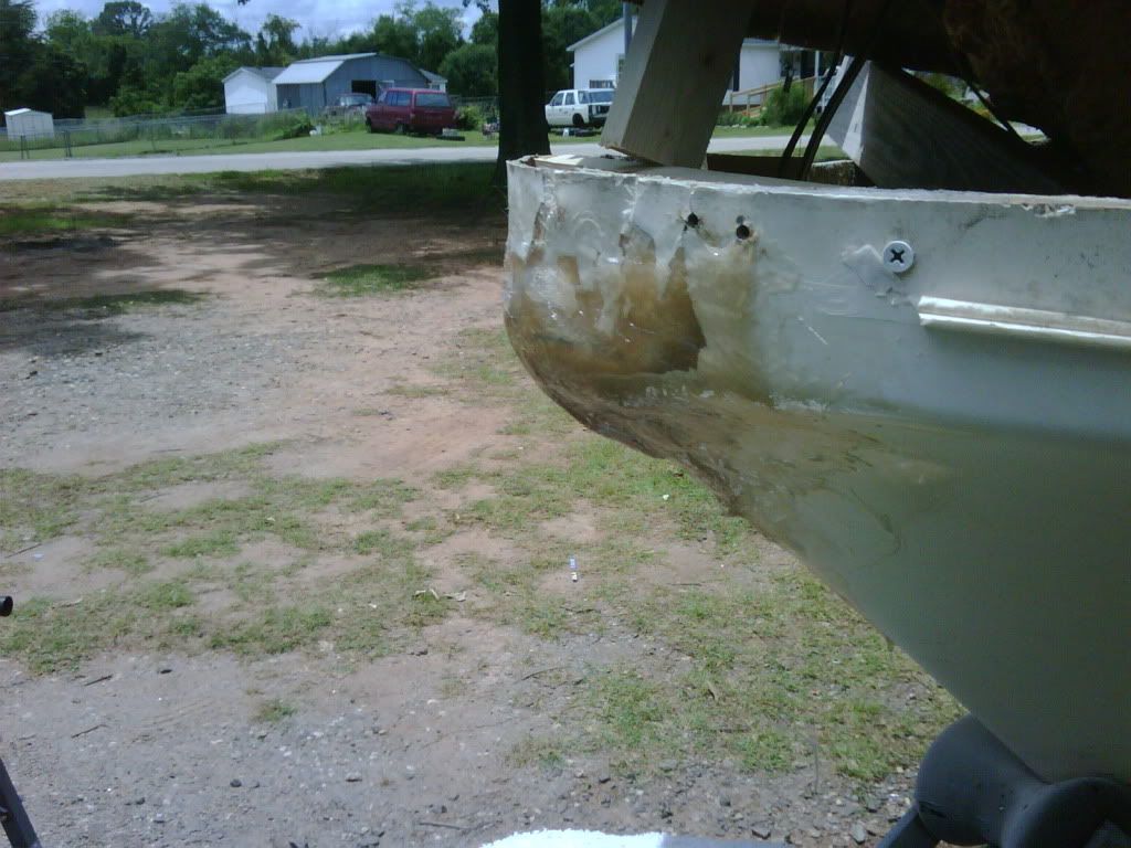

Here is what I did today.
Jig the lose part of the fiberglass in place. Then applied the patches. The nose has about 3 patches as it was so messed up that I had to build it. the rest is 4" by 10" strips. When I left it was still not dry (bit under the hour) but it was tack enough for me to be happy that the patches would not move. I think I soaked it too much as I had a bit of problem to keep the patches in the right place. I had to "massage" them and then they would stick. The brown part is where I grind to the glass. Did not extend the patch to the section that will be covered by the upper deck as not to build too much thickness that it would not go back in place.
Any input as what y'all see?
For the long story... I started to mix a batch using some old resin. I bet that resin was 4 years old. That think started gelling in under 3 minutes. I added 7 drops for half an ounce as I wanted to put a few patches see how it dried and then do the other half. This just in case I messed up the hardener amount. Since that gelled a bit too fast I thought it could be the resin. I open up a can of resin that I bought not 2 years ago. If I recall right this can was never opened. Same results... Started to wonder if my hardener amount was right. Still suspecting the resin went and bought a new can. This time there was no surprises...
Will try to put the boat back together minus the rubrail parts and I might not put the screws in the part that I just repaired. Will use duct tape to keep the water from coming in between the 2 parts. That will let us use the boat sunday and then will try to finish the fiberglassing during the week.

Not looking too bad at all! Yeah, old resin is not too good. A new can will make it easier to deal with.
Have fun out on the water.

You're off to a good start, load on the glass and then grind off everything that doesn't look like a boat, fiberglass is great stuff.
With a little grinding and a cheap can of white spray paint it may only look "redneck" at close range, from 20' it may look fine.
