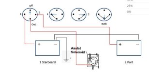

You can do it yourself. Litteraly 4 screws to mount it and then run the battery cables to the switch instead of the positive terminal in the motor. You will need just one more battery cable. See diagram.
There is one drawback with this configuration. If I remove or disconnect battery 1, I will not have power on the boat. I plan on adding a bus bar and run the 2 battery negatives to the bus bar and a 3rd cable from the bus bar to the engine block
