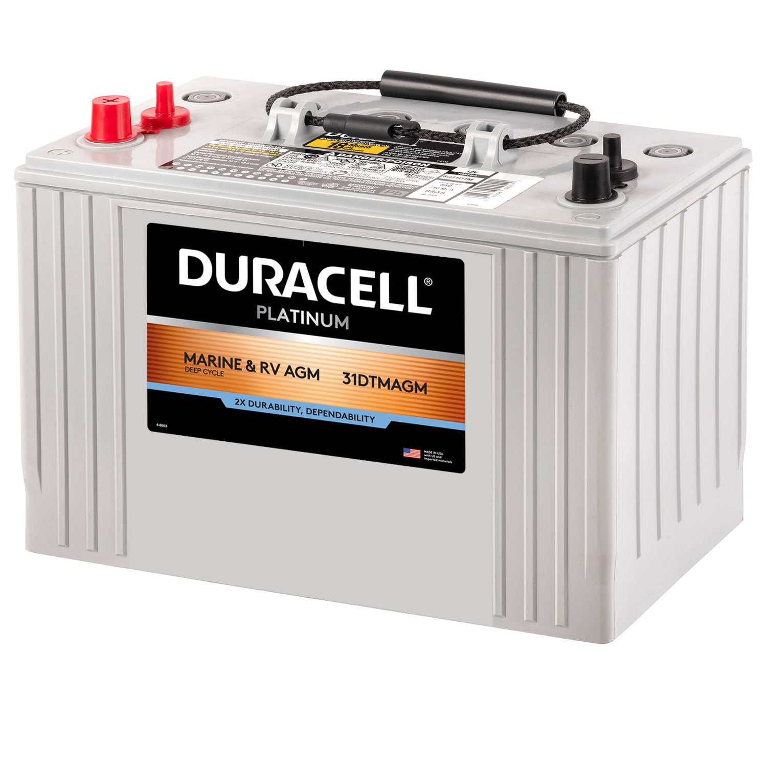

Certain newer fuel injection ignition systems have a minimum CCA/MCA spec. My 2017 6.2L Mercruiser spec is 800CCA.
My engine also has a dedicated power line form the ignition/fuel injection system straight to the battery to reduce voltage drops. I use AGM batteries that meet this spec. Many so called "Marine/RV" batteries do not. For example, Interstate 24 or 27 series RV/Marine do not.
These are the batteries I use:
