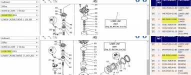

You might want to withdraw your comments about there being no standard or counter rotating lower unit on a Yamaha.

Not so in all models. Here is an example where the same gear case casing is used for both the regular rotation model and the counter rotation mode. Only some internal parts are different.
