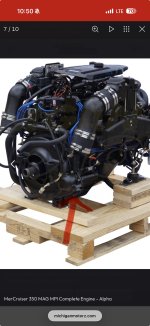

I have a 2003 Stingray 230LX with a 350 MAG engine. Last year as I was taking it out for the year I noticed it was doing this leak in the video attached. It was coming from the back left area of the engine (standing in the boat looking to the stern) and only when the engine was running. I had my boat mechanic look at it this spring and he said he couldn’t get it to do the same thing either in the shop or out in the water. I haven’t had a chance to drop it into my lake yet, but I’m curious if you guys have any idea what could be going on here.

Doesn't look subtle. Just aft of the starter on the starboard side maybe? Almost looks like from the bellhousing. Core plug? Y-pipe (seems forward of the pipe though). Can't think of any other plumbing around there if truly on the starboard side.

it looked like it was coming out of the bellhousing, I agree with nola mike. Could be a core plug on the back side of the engine...I think there are a couple there.
looks like there are 2 core plugs in that area

Also, that looks like far too big a leak to safely run with. Again, that's only with the engine running? If there is a core plug above the engine block drain you could try draining the block and then see if the leak takes longer to get going when you restart (the block would need to fill back up before it started up again).

Being that it happened after winterizing, it might to be as other say the cor plug but in most cases the block side plugs pop before the back ones. Another thing might be the power steering cooler hose, someone might have forgotten to tighten the clamp

Btw if that hose pops off the ps cooler the motor will overheat in no time & if an Alpha drive it will fill the bilge quicker than you can say oh sh!t. Happened to me back in 2013..,,
