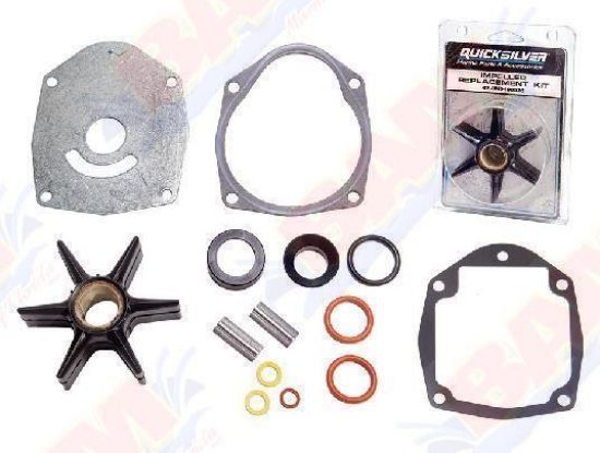

My stern drive is alpha1 gen 2 serial number 0F333583. I used quicksilver 8M0100526 water pump kit. Should I have used 817275Q05 Water Pump Impeller Repair Kit instead? It could explain some of my issues if so. Thank you

Unless you needed a new impeller housing due to inner scratching grooves, etc., you are good using 8M0100526 kit as it's just a general repair kit.​

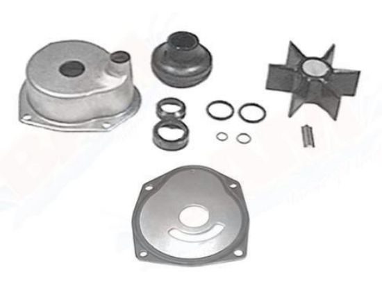

The kit ending in #Q05 is shown with both plates and gaskets that would fit either mercruiser alpha one gen ii drives and vazer drives and is of a more complete kit with a new housing as they both fit MerCruiser Alpha One Gen II drives.
#562 fits MerCruiser Alpha One Generation II 4-stroke drives, Mercury 4-stroke Bigfoot Outboards...NOTE: The 3 piece faceplate and gasket contained in this kit can be used in place of the single piece over molded faceplate supplied in previous water pump impeller repair kits.
47-8M0100526 Water Pump Impeller Repair Kit,​
817275Q05 Water Pump Rebuild Kit,​
Application Guide
Merc p/nApplicationModel Number
817275Q05MerCruiser Alpha One Gen II drives and Vazer9122789
42038Q3Mercury 6, 8, 9.9 and some 15hp 4-strokes7890064
161543Mercury 4HP, 4Stroke7917503
89983Q1Mercury 30 JET, 2-cycle Two- & Four-cylinder1663731
8M0100526MerCruiser Alpha One Generation II 4-stroke drives, Mercury 4-stroke Bigfoot Outboards1661644
16159A03Mercury 4, 5 & 6hp 4-stroke 1999 and up8720195
89984Q5Mercury/Mariner Four-cylinder and V6 Outboards1663772
96148Q8Mercury/Mariner Four-cylinder and V6 Outboards1663822
89981Q1Mercury/Mariner Outboards 4-9.8hp1663665
59362Q08Mercury Plastic 1- and 2-piece Body Seawater Pump1661842
