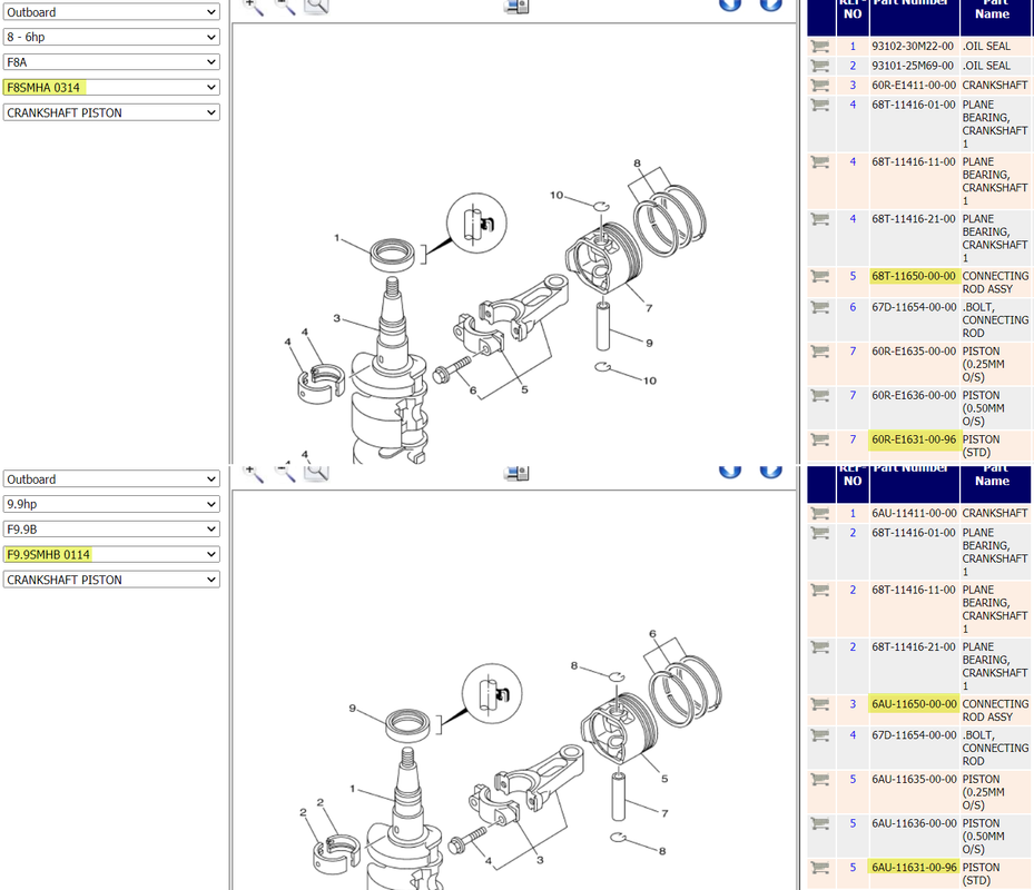

Are you trying to compare an F8SMHA with an F9.9SMHB? Just saying F8 versus F9.9 is no longer enough. These are the two models that were manufactured in 2014.
Open the Yamaha parts catalog for the F8SMHA. Open the Yamaha parts catalog for the F9.9SMHB.
Then open the same illustration for each model. Compare the part numbers for similar items. Crank shaft to crank shaft. Block to block. Cylinder head to cylinder head. Carburetor to carburetor. Cam shaft to cam shaft.
I am not seeing that the rods and the pistons are the same. As are most of the other parts.

Thank you for your posts, I now clearly understand the differences in camshafts is what makes the HP difference and the proper parts illustration shows these parts are different from each other.

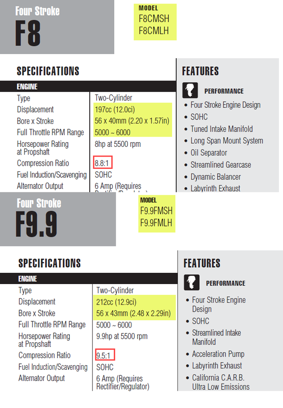

My apologies if this is an old subject, couldn’t figure how to search 1500 pages of posts on the subject. Anyway, what makes the 9.9 1.9 HP greater than the 8.0? I know the displacement, pistons, and rods are all identical. Is it in the lower unit gearing; or prop used? Is it a governor of some sort? Is it in the CDI unit? Maybe the tweaking of the carburetor? Please tell me if my F8 is the same thing as a F9.9, or not…Thanks.
From where are you getting your information? A 2010 F8CMSH is very different from a 2010 F9.9FMSH.
Thanks for the specs! Clearly I was reading the old school stuff. Lesson learned, always start in this forum if you need questions answered correctly.
