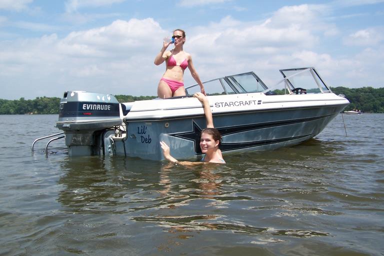

Here are 4 photos:​

I'd suggest raising the motor. It looks low compared to the bottom of your hull.
Take it to the top hole and see if the prop ventilates while turning etc.
You should see an increase in RPM (and speed).

I have had the motor raised higher on the transom, and that was 2 mph faster, but I brought it down because of too much cavitation/ventilation with skiing and tubing. I'm not concerned about that 2 mph.
The angle of tilt you see is what's needed to properly pull a slalom skiier out of the water. And yes, the boat will go faster if the motor is kicked out another notch. Again, having the most speed possible is not a concern.
