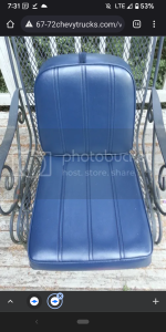

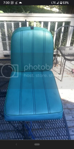

That makes sense.
I did a seat on my 65 Chevy, and it still looks good 8 years later.
But, yes, I could see that being an issue with boat seats.
Green before, Blue after:
