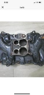

Do I necessarily have to cover this up or can I just leave it exposed with that choke off? I will be converting it over to an electric choke

No I have the old choke housing removed, I just was thinking of leaving it off & installing an electric choke. I just didn’t know if I could leave the face of it exposed.

The area in question is circled.

I'd cap the hole rather than leave it in there. Much cleaner look and won't look redneck.

I don’t care about the look as much as the functionality….also I can’t even find a plate for it

your local hardware store has metal and bolts. all you need is a hacksaw and drill.

Some of those electric choke kits have a bracket that gets bolted to that same pad where the spring would have mounted.
