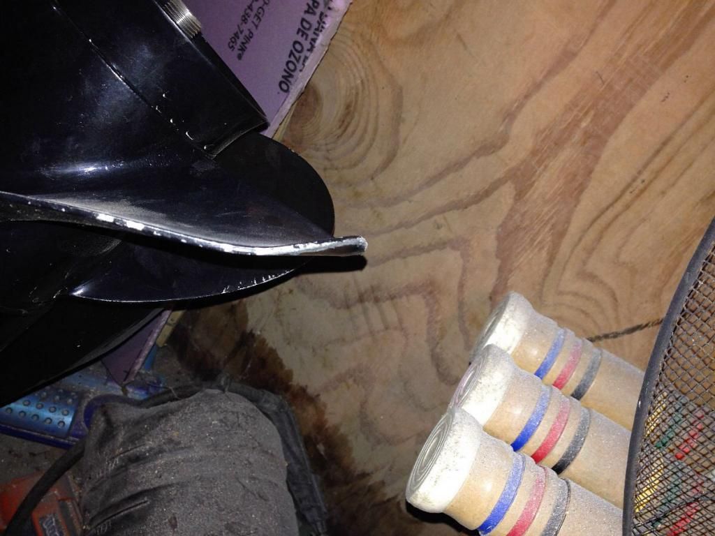

Let's see if I can post a pic... I've tried about 5 times tonight and have encountered lots of errors. This is a pic of the tip that that got bent, along with one of the undamaged tips. It's a 4-bladed aluminum prop.

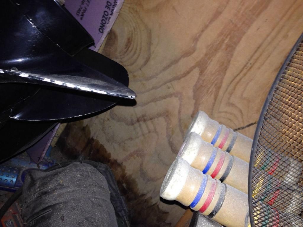

Here's another view:

Anyway, I was backing the boat away from a dock over some skinny water and I think I bumped a submerged log. I used the boat for a few days and didn't notice anything, It was only when we trailered the boat that I noticed the bent tip.
I've read threads that recommend everything from buying a new prop (or sending it to a prop shop) to just hammering it out between two heavy hammers. Not sure where my ding falls, but I thought I ought to ask...

cant see the pics here........last summer I was in the St Lawrence River and drifted back into some rocks, bent my 4 blade 15p a little in one spot.. ball peen hammer againt my wooden work bench, looks like new,, performed just fine monday in Seneca Lake,, NYS. if it's a little job you can handle, just whack it out yourself

You should have it professionally repaired buy a good prop shop. Fortunately, I have one of the best ones in the country within an hour of where I live. Not only will they check the pitch in case that changed but also balance it which is the most important.

That doesn't look too bad.
Any decent shop can straighten it out.

Need to find a better repair shop! After my local guy is done, you can't tell the prop from a new one. He cleans/repaints/balances any prop he repairs, so its very likely the prop is BETTER than new. (balanced)
