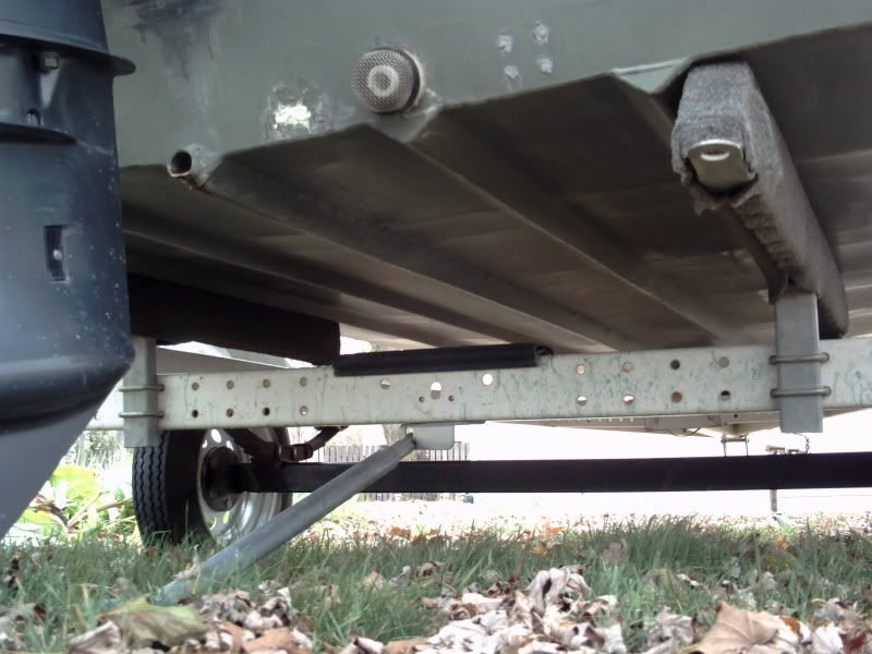

Do these bunks extend too far?

Re: Do these bunks extend too far?
Dade, you see what I wasn't seeing at all.
It shows up the best here, the bunks are really short. I guess the 2x4 cant' flex if it is only fastened in one place.
Not easy to see but the bunk doesn't go past the wheel
Thanks for the advice. I know it is kind of boring but what's worse than breaking your boat while you trailer it? Yeah the motor is 250#.
moonfish
Nov 1, 2003
128
A lot of it is unsupported.
It looks like I can run long bunks 2x4 or 2x6 and lay them right on the trailer frame. I'll make friends with a welder and I see how that welded joint isn't the best design for something that flexes, either. Thank you gentlemen.
it looks to me like the bunks are just attached to the rear cross member with more than half of them hanging off the back of the trailer. In my opinion that is not a good set up to support that 250 # four stroke. with not much weight in the front and the bunks only attached in the middle they are going to act like a see saw.
Good catch! Was thinking about changing the whole setup for my taste.
2X4's tied to the front X member w/ 2X6 running flat on top of the 2X4 (glued solid).
Shorten up the rear, move boat forward to within 6-8" of rear X member if possible leaving 2-3" of bunk behind transom. Then move axle up to balance properly for trailering.
And definately reweld that cap up.
Sounds like a lot, but I'd feel better about it if it was mine.
...Thank you for the additional pictures.
A coupla suggestions:
Lengthen the bunks if you're gonna keep that heavy powerhouse back there.
Stop by your local, friendly trailer supply store and pick up a pair of bunk pivots and install just forward of the bunks balance point.
Slide the winch post and center roller forward to place the transom over the trailer.
Re-asjust your transom saver.
Get that crack weld-repaired. The crack is exactly in the heat-affected zone of the thinner material....a doubler may be required to support the weight of the engine. Make the same repair to the other side.
FWIW....Ed in 'ol Virginny:)
You should move the winch post closer to the coupler by the same distance it would take for the transom to be over the end of the trailer. Move the bunks forward so the ends of the bunks are even with the transom. I can't tell if the bunks have two mounting points or just one swivel bracket. I prefer to have my bunks with two mounting points if you can get the bunk to conform to the bottom of the hull. The trailer jack can be moved forward also. The winch post should be no less than 24" (preferably more) from the coupler to allow for turning while trailering. The side guide-ons should be moved forward so that the rear ends are slightly ahead of the rear of the boat. I would use a gunwale strap over the rear of the boat or the gunwale straps where there is a mounting point on the rear trailer frame on each side of the motor with the strap going to the boat's stern eye. Check your tongue weight to see if you have 10% of the combined weight on the hitch ball. Then you would be good to go.
Sorry for the late post. I'm a slow typer.
walt-oxie1
Aug 13, 2009
141
I would run 2 long 4x4s and bolt them direct to the frame since it is a flat bottom boat. It will also lower the boat on the trailer since no brackets would be needed. Just adjust the length/placement them so the tongue weight is correct. The winch post may need moved too. With the boat sitting lower the uprights will help keep the boat from moving side to side. If anything I would just tie the boat down with a rope since the uprights got the side to side movement covered. You just need to hold the boat down.
