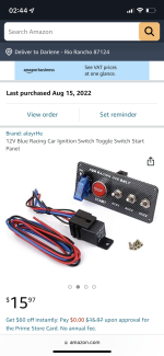

Purchased a push to start setup on Amazon, I wanted to see if anyone has installed one of these yet, I have a pontoon with outboard and wanted to see if someone could help me with how to wire this up. I’m pretty confident on wiring it to start the engine and for choke, but had question about killing the engine, the “off” position. If you have successfully done this let me how u wired it up.

First, that Chinese panel is not intended for non-automotive use
Second, that Chinese panel is not intended for a damp environment such as a boat
Third, that cheap panel doesn't last that long in a car. I am making a new panel to replace that exact POS for a buddy's car after the switches started failing
I personally would suggest you send it back to Amazon

**I agree that panel looks incredibly cheap and I'd be very leery of the price its being sold at. Probably cheapest parts they could find at that price, not marine grade.....probably more for a go-kart.
52,787
Or a Honda with stickers and wings
A good marine switch is $12, a good relay is $4, a good relay socket is $3.
The switches on the Amazon panel fall apart after 6 months

Actually the panel I am wanting to wire to get rid of using a key, I have the weatherproof covering for it, so I just wanted to see if it could be wired for a boat?
52,787
your key switch on an outboard is for magneto ignition. it also controls the choke.
the panel you have is for powered ignition.
with lots of know-how, you could get it wired. however the switches will fail. a cover isnt going to help.
