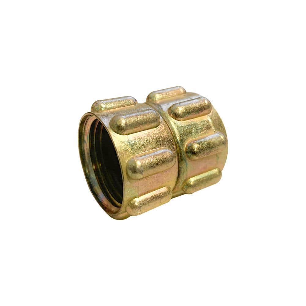

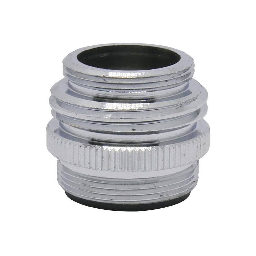

if not you can buy a couple of hose fittings such as these to space your pump up a bit.
one male to male, one female to female
your local hardware store should have something similar as well.
Great idea!
Use a female/male coupling to extend the threads high enough to clear that inner tube.
This did the trick. Muchas Gracias Amigo.
