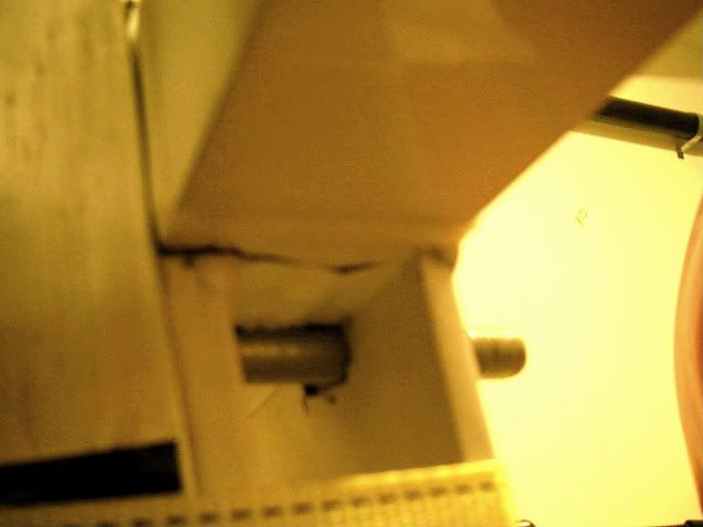

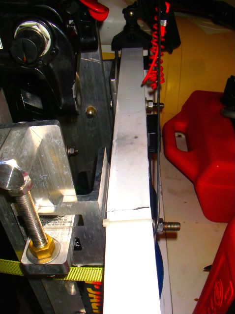

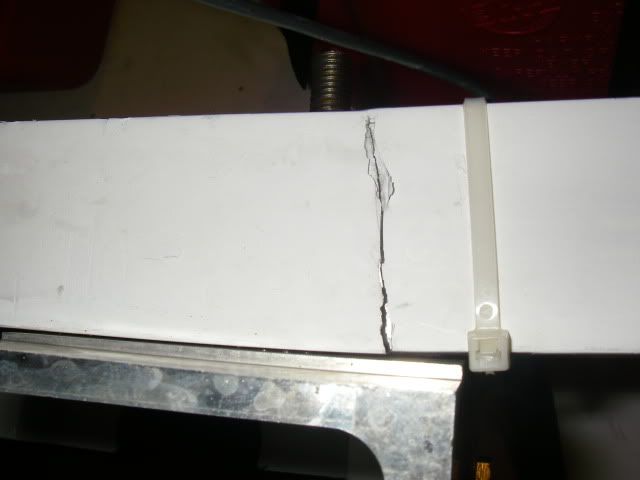

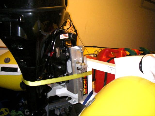

Hello everyone,
This boat has been giving me some grief lately. Mainly because of the longshaft motor that I have. I know I should sell it and get a shortshaft 40-50, but right now I do have the longshaft and have been working around it. In the process I'm sure that is why my transom cracked. I had to use a jackplate to raise the motor for the correct height. It was working for a while but when I was out yesterday I noticed the crack in the transom as I was motoring back in.
Here are pics of the crack. If anyone can please share on any reinforcement tips and how anyone repaired a cracked aluminum transom. Thanks everyone.

Here's the current setup;
topview crack;
closeup view crack;
underside view crack;

That is definitely a bummer.Square aluminum section like that doesn't seem like a good choice. Aluminum really doesn't like flexing, cracks and breaks are to be expected. I don't think I would be comfortable with just welding the aluminum square section break. Sure looks like a new transom is in order. Wherever your jack plate ends there is always going to be a concentration of stress. The jack plate and motor mount assembly are far stronger and more rigid than the transom. Nice the way the vertical transom tube is positioned right at the spot too. Considering the hassle to even try and get the transom welded, the cost of an new aluminum transom and possible reinforcment maybe a trip to your local metal fabricator is in order for a ss replacement. Probably better than trying to reinforce the aluminum transom with two sandwiched ss cut plates. Good luck, sure wish my boat could fly.

Hi Jeff ..... you can get it welded but it will just keep on cracking, there is way too much stress on that transom .... you need a 2-stroke shortshaft ....
