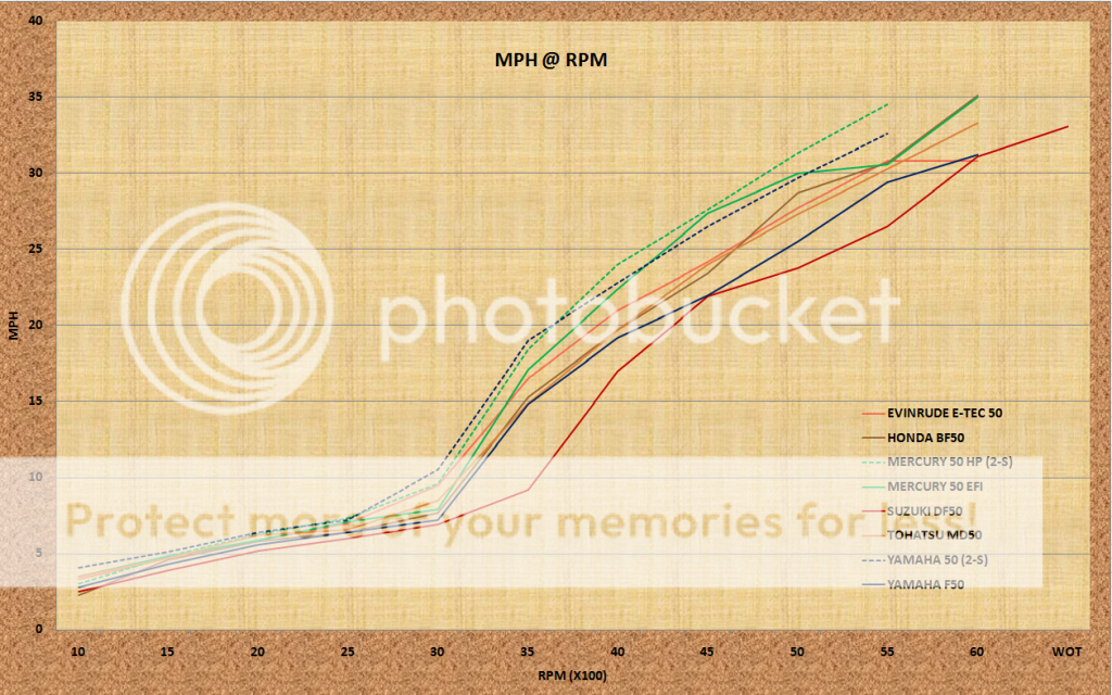

Charted the data to Excel. Click on thumbnails for larger image.

Hard to think there was that much difference.

I can't believe how bad the etec underpreformed. I wonder why I thought dfi's were fast as the old school 2 strokes? It was the best for trolling. I am currently in the market for a 50. look like the merc is the way to go.

The 40 and 50 Etec are the dogs of the line. Their performance is a little off, but in every other respect they are equal to or superior to almost everything else.
