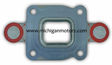

I am in the process of replacing my exhaust manifolds and elbows on my mercruiser 4.3
The engine has a dry joint system that was originally raw water cooled. A long time ago I converted it to a closed cooling system for the engine block. manifolds and elbows are still raw water cooled.
so after pulling everything apart, I see the gasket is an open flow gasket. The manual says to use a restricted flow gasket. Which one should I be using?

If the raw water exhaust worked after conversion to half system replace with the same
Fun Times
May 16, 2009
9,370
GENUINE MerCruiser dry-joint riser gasket for DRY-JOINT manifolds and risers from 2001-later. Both water ports are wide open for applications with spacer blocks between the risers and manifolds.
GENUINE MerCruiser dry-joint riser gasket for center-rise DRY-JOINT exhaust manifolds and risers from 2001-later. Gasket water ports are completely blocked-off for closed cooling system applications.+Used only on closed cooling (fresh water) applications.
GENUINE MerCruiser dry-joint riser gasket for DRY-JOINT manifolds and risers. One of the gasket water ports is partially blocked-off to build system pressure and engine use in cold climates to maintain system temperature.
