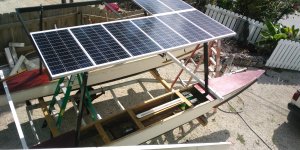

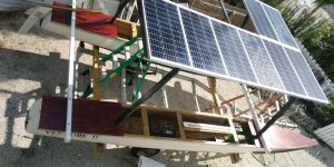

Jim Hawkins
Mar 11, 2013
510
nola mike
Apr 22, 2009
5,956
Looks awesome. So what's the total kw of the panels now, and ah of the batteries?
