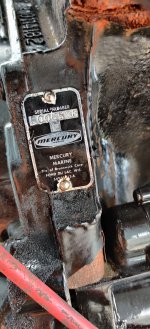

Apologies i must have submitted the wrong serial #, the correct one is F006526. Also there is currently a relay controlling the oil pressure switch and the pump. What would be the proper connection to start the pump while cranking untill it builds up pressure?

Thanks for the SN, the starter (Gen V 92 to 94) should have the extra terminal. So it could be wired up as in the first pic

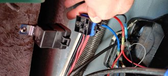

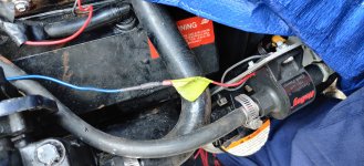

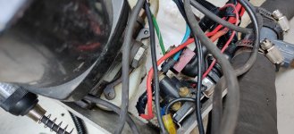

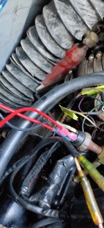

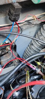

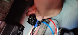

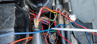

Here is what the relay and connections look like, to be honest this is a mess but then again it works fine after a little cranking. The starter does have a connection which the purple wire should connect to but the purple wire only reaches the ignition coil. Here is how the relay is currently wired. Blue wire to pump positive, white is ground, black to oil switch, Red wire from relay to battery pos and spliced to oil switch and them from switch to yellow red starter. All the diagrams i see state different connection point.

alldodge
Mar 8, 2009
44,643
That pump is not marine rated (ignition protected), its illegal to use on a boat.
Does the motor have a belt driven raw water pump, and if so does it have a place for the fuel pump?
To fix what you have, suggest connect one side of the switch to the purple wire coming from the (+) side of the coil.
The other side of the switch goes to the pump
Run a new wire from the outside terminal on the starter to the fuel pump side of the oil pressure switch.
Remove everything else
