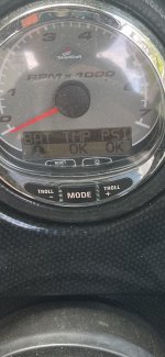

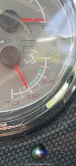

Photos of motor and gauges

All gauges and dash lights come on, just says there is low voltage and that the motor startup process will not function. The first pictures of the gauges I uploaded is what the gauges are doing right now when I turn the battery switch and try to turn the boat on.

ok, a boat gauge may not be accurate. I'm seeing 12V on the gauge which should be enough to at least try. Its not trying so the PCM is seeing voltages lower. It could be on the 12V side or the 5V side.
Sensors use a 5V circuit coming from the PCM. Would need to measure voltages at the TPS, water pressure, crankshaft or MAP
Measure power at the helm key switch Red/Purple wire with key off. Leave meter there and turn key ON and see if voltage drops. Then measure power on the purple wire with key ON
