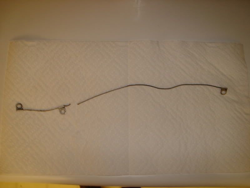

FOUND IT!!!
Ground strap between the block and mount.
I?d been cranking over the starter several times a week for the last couple weeks and it?s worked fine every time. Assumed then the problem was just dirty contacts. Yesterday I go to put all the wires back where they belong and finish up the project and when I went to pull the ground strap to slip it on the stud, it just kept coming.
This thing must have been slowly breaking away the last couple years. Sometimes my tach or speedo wouldn?t work, then it would. Also about the last year or so, when I?d start the outboard, the sonar would turn off. Finally it just got so bad that the starter wouldn?t crank right. Don?t know why it?s been cranking good consistently lately. Maybe by fooling with the wires I had it making a good contact temporarily.
Anyway, ordered a new one. Should be in Friday.
MAN! What an ordeal!!!!
