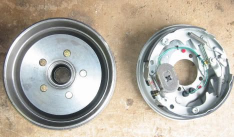

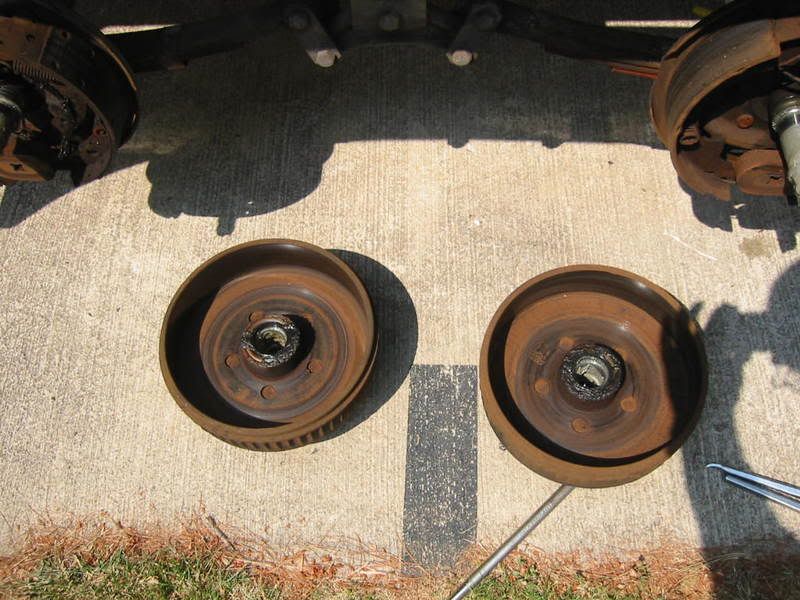

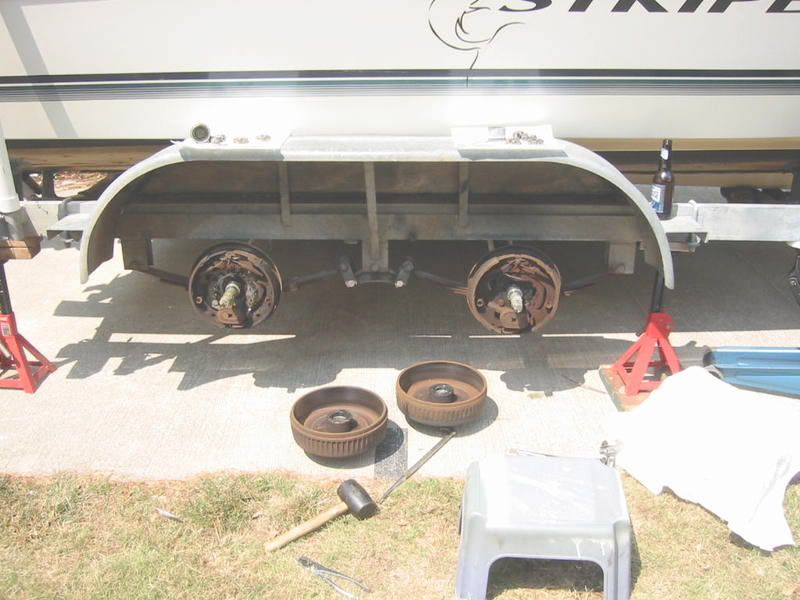

I too run electric brakes on my boat trailer and have for nearly 50,000 miles.
As CR Cruiser says, the magnet surface on the drum does rust but with regular use that rust can be 'run off' by a light pressure on the brakes for a spell.
And there are electric brakes specifically designed for salt water - Sharkskin.
We do 80% salt but when we do, a dip in fresh water on the way home is usually the rule.​
Positives about electric brakes:
Control from the cab (for fishtailing or backing down the ramp)
Adjustable - for loaded or empty trailer
Very simple four bolt, 2 wire installation
No bleeders or close tolerance hydraulics
No moving parts in the coupler
Cheapest brakes you can find​
Negatives are:
Need to be adjusted regularly
Not up to snuff when wet or after sitting (rusting)​

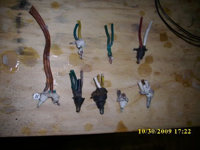

When I install a set of electric brakes, I wire them in by using a wire nut filled with silicone or 5200. I've never had any electrical problems. Here's a few examples from brakes and lights that I've replaced, none of which show any sign of water intrusion.

All I have so say is WOW to these connections above. Accident waiting to happen.
Please tell me you don't really use lamp cord or speaker wire(wire on the left) for the electric brakes on your trailer!
