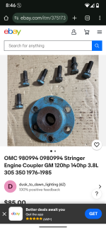

53,456
There is no 2-piece RMS button coupler for a stringer 800 that I have found , and the 1-piecs RMS pattern is different.
The bolt circle on the 2 piece rear main seal crank is 3.58" while the 1 piece is 3.00" bolt circle
The Ford pattern is close to the 1-piece.... however with one hole rotated about 4 degrees
If there were, it would open up a bunch of avenues for people. I know the Ford coupler can be modified by drilling another batch of holes, or welding the one up and redrilling

i researched the sh!t outta the coupling when i got the new shortblock.
it required the staggered-bolt starter, which requires the 14" flywheel, which i didn't have either of...so before i started engine assembly, i had to make sure a 14" flywheel would fit. then i had to make sure the coupling would fit my crank, so researched that for a while, too.
i found and bought a 14" flywheel for a 4.3 (mercury 12557590) and proceeded to trim my housing to fit. here's a pic (edit: sorry for the huge picture...dunno how to resize it.)
this is the 14" flywheel in the housing, with the coupling centered under it.
the coupling for all 3.8/5.0/5.7 that i found is OMC# 0980994. i do remember verifying this number on the coupling i have, but no pic of it.
after verifying everything fits and torqueing it down, i checked runout to make damn sure it was right. runout was ~0.001" at the coupler edge.

53,456
The coupler for a stringer does not care about the flywheel, only the crank pattern
The only Stringer coupler for GM motors only fits the 1985 and older 2-piece RMS cranks
