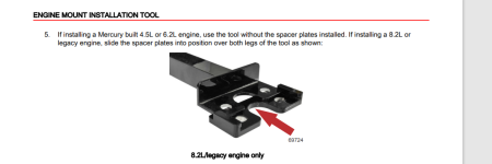

So I bought an engine mount installation tool.. I got it used after receiving the tool and looking up at the instructions for the tool it seems that I need spacers that come with the tool but when looking the tool up there is no mention of the spacers at all does anyone have any experience with this tool.. part number 806794A02 and instruction sheet below

Its in step 5 - seems like if you are installing the newer merc made 6.2 and 4.5 engines you dont need the spacers. If you are installing a 8.2 (assume GM based) or legacy engine, which I suspect is any of the older GM based 4.3, 5.7, 454 gm based engines you need the spacer...
I have never used it -The only thing I'm thinking it will affect is the height if the front mount.
When I repowered 4.3=>5.0 I just set the engine with mounts on the stringer and used a 18" drill spade bit to drill the new holes after getting an initial alignment. As long as it aligns its not rocket surgery.
Page 4 of the guide you attached shows the spacers for 4.3 and 8.2/legacy (aka any Chevy V 8 engine...)

Yup I seen page 4 where it talks about using the spacers.. but it doesn't list the spacers anywhere that has the tool available to sell so I was thinking the tool in the installation sheet may be a newer tool and and the was hoping the spacers where not required for the tool I have .
Ok wasnt sure what your question was. Looks like you were sold part of the tool … looks like those spacers are 1/2” or so thick. Would think you could determine the thickness off mercs installation drawings. They are available on line https://samerwebapp01apncus01.azure...e-9186-4ce3dfaead13/43lefialpha_1996-2001.pdf

Ok do I reached out to the manufacturer of the tool they saidvthey don't sell the shims independently of the tool but they did tell me that the shims are .450. So almost an inch..
I would take that as almost a half inch. Or 45 caliber..
