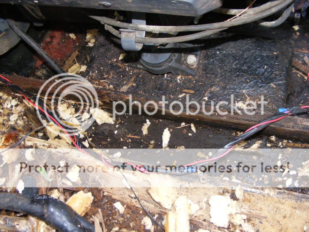

Yeah I definetlly want it fixed correctlly thats what I am asking you guys your opininons. I would like to just go over the boxing not the acual engine perches, I want to toltally rebuild them. But I would like to just epoxy in new wood surrounding the engine though. I am going to try to post some pics here thanks guys
Phazer230
May 28, 2009
108
Re: Engine mount replacement questions?
What do you guys think? What a mess huh

Phazer - I have bad and good news for ya.
Bad news: Your bilge and engine compartment are toast. Yep - all of it; not just the engine mounts.
To do this right, you're going to need to pull the engine and drive and get to work. I'm guessing your transom, sole and stringers aren't far behind. There's always more rot than you anticipate.
Good news: Check the link in my signature - I started with a similar problem and fixed it. I just got back from two days at the lake with my freshly repaired '89 OMC 4.3 Starcraft. Now my only issue is my prop doesn't have enough pitch. ;)

Yeah the stuff around the engine is definetlly toast, but I think the transom is ok. The stringers arent the greatest but I think they'll work the ones on up the boat anyways. The engine compartment is my biggest issue right now. I think and hope the rest of it holds up it seems sturdy enough but all tyhe wood around the engine is gonna have to be replaced, but cant I just cut off the mounts and epoxy in new wood around the engines surround and build new mounts? anyone?

The "boxes" that the engine mounts are bolted to (lag screws) aren't just fiberglass but they're dimensional lumber i.e. : 4x4 with an angle cut in it to match the hull with some heavy fiberglass over it (3/16''-1/4'', at least on my boat, you'll want to replace whatever you remove). They're glassed to the stringers though when I replaced mine I peanut butter-ed them to the hull AND to the stringers as well.
They look bad though from here. As mentioned it's best to get it over with now. You won't have to make another mess next season and won't have to worry about any structural failures (or worse)
