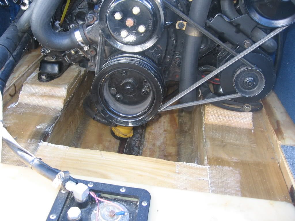

Alright, I took the boat to the shop and had them pull the engine and lower unit a couple of days ago. I have posted threads on here about my "tiny leak" which, it appears, has been a problem for a while now, as my stringers and motor mount blocks were mush.
After they got the engine and drive unit pulled, they called me and said they found no evidence of a leak. I said fine, and got the boat home and cut out the stringers and cleaned out the bilge clear down to the fiberglass hull. The floor was rotted too. I got to poking around on the transom and found a rotted area on each side of the lowest transom unit bolts. I took the boat back to the shop and had them pull the transom assemble, and there it was. Water was leaking in through the bolts where the anode are. Glad I had them do that.
Any way, I took some pics this morning, and if someone will tell me an easy way to post them, I will put them up.
I have my work cut out for me. I have to rebuild my transom, floor, stringers and mounts.

http://i306.photobucket.com/albums/nn264/phish555/boat repairs/IMG_2299.jpg
http://i306.photobucket.com/albums/nn264/phish555/boat repairs/IMG_2296.jpg
http://i306.photobucket.com/albums/nn264/phish555/boat repairs/IMG_2297.jpg
http://i306.photobucket.com/albums/nn264/phish555/boat repairs/IMG_2298.jpg
Pics I took this am. Hope this posts! You can see I have removed the port side engine mount/stringer. You can also see some of the rot in the transom.
I will post more pics as I make progress.

I got all the rotted wood out. Included some flooring, transom, engine mounts and the stringers they were build on. After removing the stringers up to the point where wood is dry, I noticed the foam (between stringers) is good, not rotted or soft. Taking out the foam is like taking apart a jigsaw puzzle. My question is, when I am ready, can I fill the void between the stringers with that non-expanding foam used for insulating new windows on a house? It comes in a can, and is sold at hardware stores. I will post some more pictures this weekend of my project.
Coors
Dec 8, 2006
3,367
Re: Engine mounts?
See Boat Restoration Forum.
The foam has no use, unless used as a mold for the fiberglass repair facing you.
Sorry. You have weeks of work, before the engine goes back in.
