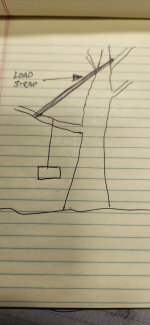

If you think the tree is strong enough, add a strap or chain to the outer part of limb to sure it up.
(As seen in my beautiful art work) :)

Yeah, honestly this is probably the easiest solution, my neighbor has a backhoe, but often it's at a job site. Thanks guys
