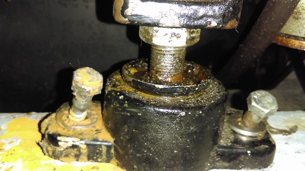

redneck joe
Mar 18, 2009
16,439
Listen to these folks they haven't steered me wrong yet. replace the gimble. The coupler will be an engine pull.
my coupler went bad while on plane and apparently in the process killed my gimble. My noise was much worse but again I was at speed.
The coupler failure was caused by bad alignment. The bad alignment was caused by the mounting bolts not being tight from why my @*&$@*&$ previous mechanic didn't tighten them down when they put my motor back in (new transom) so every time I gave it juice the motor tilted and became out of align.
with as low hours as you have there may be other factors causing failures.
