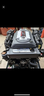

Here is a pic of the newer 6.2, if I’m correct. This will be one of the in house non GM units I think.
