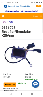

39,627
The rectifier sits on top of the block.---It is water cooled.----Therefor it has a gasket.-----Are you pushing the key in and holding it in while cranking it over for cold starts??

Didn't see any water nipples on the rectifier....maybe I'm wrong.

39,627
You mis-understand how these motors are put together.----The rectifier mounts directly over the water jacket.----There for it uses a gasket , 0350357 is the part #.
saltchuckmatt
Jul 19, 2019
3,208
Or, since water doesn't go through it, the gasket insulates it from the hotter aluminum.
Two ways to look at it.
