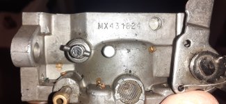

I am installing a new carburetor cover to replace the broken plastic one. I found very strange pins (seen in figure) in carburetor top surface, and I do not have any idea of their purpose except a trial to repair the broken plastic cover, where two pieces were also glued. Does anyone have idea about the purpose of those pins? There are no holes in gasket or cover for those pins. It was easy to remove the pins, but I think the small holes in the carburetor surface are original?

They don't show any pins in the parts breakdown

This is ok now. The small holes are probably kind of air vents. They became covered by the cover gasket.

Use a small pick (even a tooth pick) to see if the holes in question are open air holes. It's been too long, and my memory is too short, but are there four or five pegs coming down from the cover (with some broken off)? Probably for placement of the gasket?
There are two or three gaskets of differing configurations in the carb kit, and holes there might be a clue to open vents.

No .
Those pins do not belong.
What you got there was rigged by Jerry.

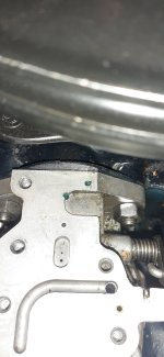

It is clear that those two holes in the upper right corner of the carburetor surface definitely don't belong there. They have been drilled through the wall, and the other one most likely causes air leak since my new cover gasket covers only the upper one. What would be the best way to fill the hole(s)?

Why would anyone do that?? And what I don't understand is in your original picture they were sticking out....how did the plastic cover even go on?
You need a close up of someone else's carb.

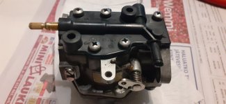

Number is here

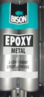

Extra holes cold welded
