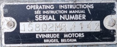

I knocked over this Evinrude Fifteen Worktwin. I need spareparts for waterpump, maybe fuelpumpkit, thermostat, gearbearings, o-rings and gaskets. I don't have full view yet.
The engine has very nice compression on both barrels.
Do anyone know if this model is compatible to later models ? IMG_20221124_084206.jpg

Thanks for quick reply.
Do these 18's have to be the same age? Or can I be lucky to make later (70s parts) fit?

The 18 hp motors were made for many years, with many minor changes along the way. Not only that, but if I am not mistaken, the 15 you have is a reincarnation of the Gale 15hp, last made in 1963. Bottom line is that comparing parts with older/newer motors, has to be done on a part-by-part basis. See if you can find a specific parts book for your 15 and go from there.

I believe I have some 15 HP paper parts manuals somewhere.-----Have a 66 model myself too.

I believe that most parts up to 1972 are the same, then many changes start happening
