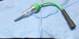

I'm using a simple inline tester. Top wire has weak spark and will not start if I have the plug boot off the bottom spark plug. In reverse, inline tester shows very bright spark on the bottom and motor will start whether top boot is on the plug or not. I will swap the two spark plugs around tomorrow to see if maybe it's a bad spark plug. I had the flywheel off and you can check resistance on both coils all the to the plug boot, they read 5.6 to 6.1

What is the Gap on your Inline Tester? If less than 3/8", it can spark all day, but there is no Guarantee that once the Compression Rises in the Combustion Chamber, that will deliver a spark strong enough to jump the gap on the Spark Plug

Jimmbo, looking at this tester, it looks like the gap in it is 3/8.

39,761
Glue 2 wires onto a piece of cardboard / plywood.----Space them 5/16" apart.-----Does spark jump the gap , yes or no ?
