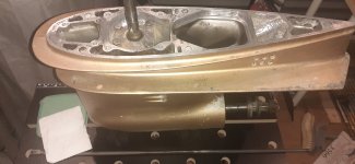

I don't know whether it was easy or not with a small screwdriver, but it is done. Seal seems to be so good that I don't know if it needs to be changed at all. I was just thinking, as the gearcase is open now, if it were good to change the driveshaft seal as well, but maybe I don't do it.

???-----Some love to argue.-----If (a big if ) the oil seals are original they need to be replaced.----These gearcases are not robust.-----Parts are expensive if available !-----Good used gearcases are at a premium.

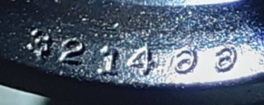

I am replacing the drive shaft oil seals and found these numbers in the old one. The last two numbers are strange and as far as I know they should be 66 (#321466)? Numbers are very small to read, but this is what I got. Any experience on this part number?

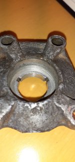

I was wondering what is the purpose of those three slots in this drive shaft cover? Another question concerns the metal parts (e.g. springs) of the aftermarket oil seals which are not stainless. Is it always so in the aftermarket parts as the original ones are stainless.
i believe the oil slinger pushes oil up there at some pressure for the bearing. needs a path for the seal too. being a 15'' short shaft as racer said best bet is to get a good used gearcase housing as complete ones are like hens teeth and very expensive and still a crap-shoot
