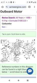

The roller shouldn't go on the plastic top??? Original motor had the front needle as well so I'm confused. Is part 21 installed and in good condition?

Yes a new #21 is installed. I need to take a look at the cover I used. Maybe there is no way for air to enter the top of the carb?
