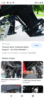

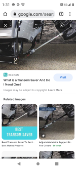

saltchuckmatt
Jul 19, 2019
3,285
I have 11" of clearance under the motor when it's not tilted and when locked down it's rock solid. Should be OK, right?
Not sure anyone is going to sign off on that but it seems fine if not traveling far. Here is what people are talking about, transom saver and motor extension lock I believe like racer said.
