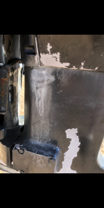

My evinrude starts for a sec and shuts off flywheel becomes stiff to the point it will drain the battery noticed metal shavings coming from the bottom of the motor any ideas of whats happening any help is greatly apriciated

I see nothing as far as metal shavings in your pics, flywheel stiff??? As in its hard to turn it??? You said running fine for four hrs? So were you trolling for four hrs or going spot to spot for four hrs as in run to a spot and fish then restart and run to another spot?? Shavings coming from the bottom of the motor?? At any time did you have the cowling off?? The post above about the rings being bad could be making the flywheel(crankshaft) hard to turn but you wouldnt see shavings anywhere from that on the outside of the motor...also if you didnt have the cover off the motor the day this happened im 99.9% sure those shavings you speak of did not come from the powerhead and if somehow they did come from something on the powerhead they didnt come from inside the engine because with the cowling on they could not have got to the area you posted the pic of.. Only thing i can think of is you have some part of your mag plate rubbing under your flywheel and if so how they got to where you showed the pic is beyond me if the cowling was on the motor...did it sound different when you tried to start it back up?? Any grinding noises???
I was fishing spot to spot nothing was opened up on the motor we fished with the motor off for about an hour no issuses then we tried to move and the flywheel got stuck and drained the battery never removed cowling

Ok....that helps. Take the cover off and look around for metal shavings around and under the flywheel and anywhere in the lower cover or the pan as some call it. Also see if you can turn the flywheel by hand and if you can does it feel smooth or feel like somethings rubbing or a grinding feeling... Do you have a better pic of those shavings you saw?
