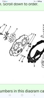

Ok I'll give it a try. Well according to the parts diagram there's a drain valve,I'm assuming it a purge valve? #9 in the diagram

That is the purge (drain) valve. Wanna history lesson? Go back a few years and there were two drain valves (actually one double-ended one) #14 on this diagram. Those drained more areas of the crankcase. And the drained oil was dumped straight into the lake. Around 1968-ish, the drainage was dumped into the exhaust stream, hopefully to evaporate some of it, then still into the lake. Then 1970-ish it was modified again, now draining still fewer areas of the crankcase and the drainage was routed to the upper cylinder to be burned instead of being dumped. Yeah, right, All that did was flood the upper cylinder with extra gas making it richer than the lower cylinder, and harder to adjust for somewhere equal mixtures. As I indicated, we got lots of complaints, especially from customers that traded in older motors. that ran so much better than the new ones.
Symptoms of plugged purge valves aren't plugged at all---they just do not exist as they did in the past.
I was there in the dealer's shop in those days, trying to satisfy those customers.
