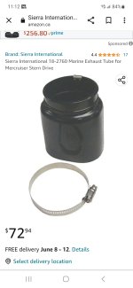

Is this the tube we are talking about

I run one of those, no exhaust bellows at all.
I think MerCruiser stopped using exhaust bellow some time ago.

So you can run boat with out it. Sounds sketchy to me lol
Absolutely no issue , exhaust is open at propeller hub so exhaust cavity is full of water at rest. Merc makes an exhaust tube that is connected on one end only. This was first done for bigger engines to lower back pressure but a lot of people use them because they are a heck of a lot easier to install than the full bellows.
my exhaust bellows ripped three seasons ago, ran it for two more years before did the full transom kit with all three bellows

Tube is designed for a bravo model. Specifically a sbc with bravo 3.
If you install a tube instead of bellows your exhaust will be noticeably louder at idle/low rpm and will soot your transom
I've been running one for years. I didn't notice any increase in noise (certainly not at idle), for sure no soot anywhere.
