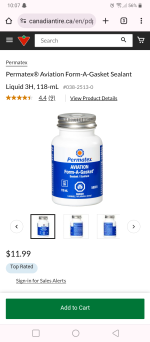

and no matter what gasket ,wire wheel both surfaces, then PermaTexAviation sealant both sides
