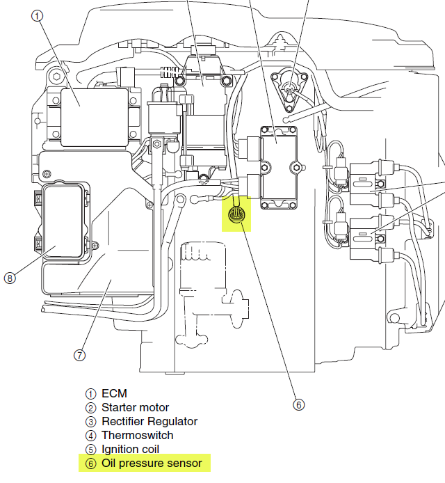

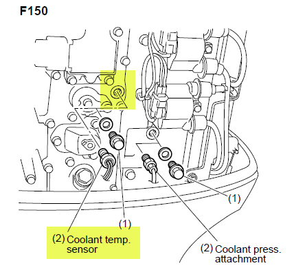

I need to know where to install the sending units specifically for F150
This Site has a Parts breakdown diagram and places to order, if not the Crowley Marine one does. Shows IF there was a oil pressure sender or just a switch.

You will need to craft a T fitting so as to get oil pressure to an oil pressure sender.

No to the wiring being installed.
With a Yamaha temperature gauge and temperature sender the sender has the wire attached to run to the Yamaha gauge. I have no idea what the Faria temperature gauge and sender consist of.
Yamaha does not offer either a mechanical or an electrical oil pressure gauge. You will have to design and create your own.
