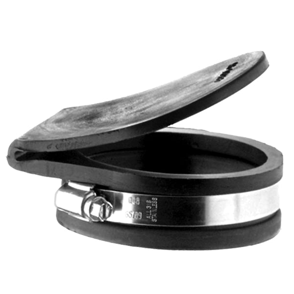

Rather than replacing with the OEM part, does anyone see anything wrong but removing the y pipe flappers and adding a universal exhaust flapper to where the exhaust bellow clamps on? I'm thinking I could just cut that exhaust bellow and add on the universal flapper to the outlet pipe from the transom. The only difference I see is no water will pass through the outdrive and through the prop on its way out.
I was looking at one of these:

My guess is it may work okay if you can find the right size and it doesn't interfere with any of the other transom assy components
Caveat may be louder exhaust noise and chance of sooting the transom
You could also abate the flappers, keep the bellows in place and operate the boat knowing the risk of water entering the exhaust. No saying how long you've gone with the current flappers compromised without fail anyways.
Big block V-8's tend to have enough exhaust pressure to keep water out, even at idle speeds. Just need to be cautious of waves hitting the transom when moored/engine not running

Thanks for the input. I do want to have some sort of flappers because I have to go in reverse a lot backing up to lobster nets and sometimes that swell is strong and I could see it going too far up the y pipe.
I just dont see these style of exhaust flapper below the water line and wonder if that would be an issue. i wonder if at idle the exhaust is strong enough to push the flapper open against the water pressure. I guess I'll have to test it out.

I've got a rigged-up single flapper on the bottom of the pipe that has worked for me for a while. Maybe I've just been "lucky"? Mine's the 4.3L Cobra; don't know if it'd work for yours or not.
I don't recommend it based on the more cautious opinions; I'm just sharing my experience. My boat isn't ever anchored or moored with waves hitting the back of it, but it's had a throttle chop or two. I generally slow it somewhat gradually.
I think a wave would tend to close mine, sort of like the one you pictured.
