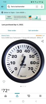

My tachometer (RPM guage) is stuck right above 0 won't do anything when I turn it over checked all the fuses they all look good. What else can I do without full blown replacement?
All wiring from tach back to distributor looks good. No kinks or anything in it. If your thinking replacement. Where can i get one with the black ring?20220404_170728.jpg

Looks like a Faria F33103 . . . why do we always have to do the parts lookup for people? It seems like they don't come with the black rims though . . .

32905 Euro after about 1 hr I found it I think. Waiting on stingray or faria to confirm now.​

they only have 2-3 year limited warranty on specific parts. They wont do anything with this old one. They provided proper PN# With black bezal so i dont have to change the rest of the working ones.
